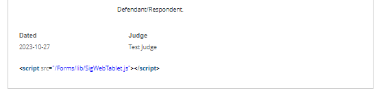

replied on October 30, 2023
Hi Keisha,
I can see from the screenshot that the <script> tag is directly showing on the form , while normally it shouldn't.
Is there any JS error in the console when loading or submitting the form? Could you double check your Topaz Signature Pad setup on form? :)
replied on October 31, 2023
Hello Yuxuan,
In step 2. part C. it states to add an custom HTML field and what is what I did. Is there a different way to complete this step? I am also not seeing any JS errors.
2. Add custom html field to the form
    a. Get SigWebTablet.js from  http://www.sigplusweb.com/SigWebTablet.js, you can just copy and paste from the page and save it into a file named as "SigWebTablet.js"
    b. Put SigWebTablet.js file into Forms/lib/
    (You can put the file anywhere in the project as long as it is the same as the src path in the script tag so that the file can be referred)
   c. In form designer, under Layout tab, drag a Custom Html field to the canvas, and inside Custom Html field, under Basic tab,  click on Html tab,  and paste in the following line:
       <script src="/Forms/lib/SigWebTablet.js"></script>

replied on November 1, 2023
Hi Jeff,
For custom HTML could you double check if you pasted in the Html tab, usually if you paste script tag in Html it shouldn't show on the page.
And If you pasted it in Visual part then it won't work.
Hope it helps!
Thanks,
Yuxuan

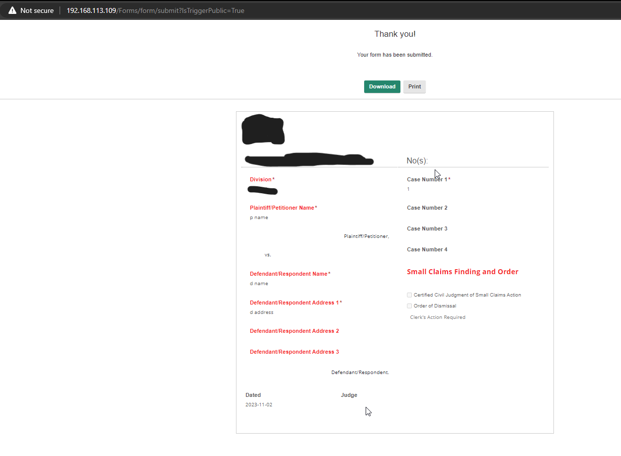

replied on November 2, 2023 Show version history
Hello Yuxuan, @████████
I added the script in the </> tab of the Custom HTML filed I still can't sign the form. Please see below. I click submit and the form loads as normal, no screen appears to sign.

replied on November 5, 2023 Show version history
Hi Keisha,
I noticed you are using the new form designer, and you are adding some customized javascript code in the JS section, however this is not supported way with the new form designer. And Topaz seems not supported in new form designer either, so you may try with the classic form designer.
replied on November 6, 2023
Hello @████████,
in a different post a couple people verified it would work in Laserfiche 11, with the modern designer. @████████@████████
Forms 10.2 & Topaz Signature Pad - Laserfiche Answers
Hi Keisha,
I just confirmed with @Rui Deng, this is not supported in modern form so far, because the javascript cannot work in modern form designer. You should tend to classic form designer, which I believe you already find the steps to follow up.
replied on November 14, 2023
My apologies for any confusion here, we were only able to get this to work with a classic built form.
