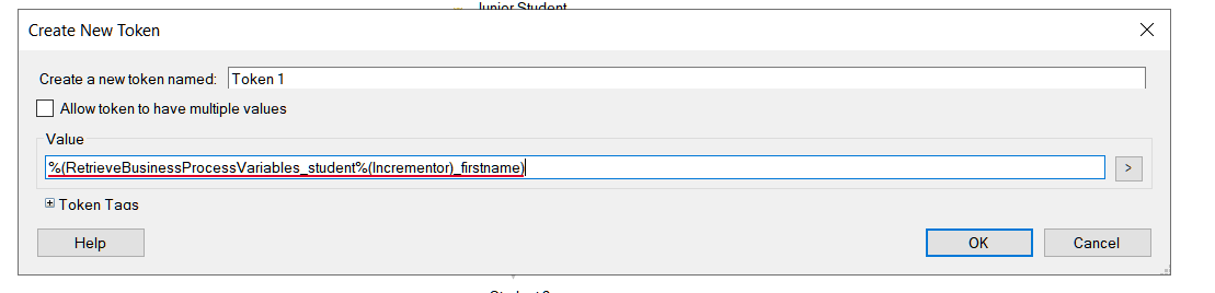

So trying to increment a variable using a token(called incrementor) as below, but its giving me an error.
Thanks Stephen, yes I have been using multiple tokens for other aspects but I'm, stuck on this one. Maybe I have been staring at it too long!

You have %(RetrieveBusinessProcessVariables_student%(Incrementor)_firstname) as your token value. Is that %(Incrementor) in the middle your counter token, and you are trying to make it return something like %(RetrieveBusinessProcessVariables_student3_firstname)? If so, you can't do that.

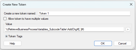

Using the token creator myself, here is my example if I want to get all values from a particular table field:
