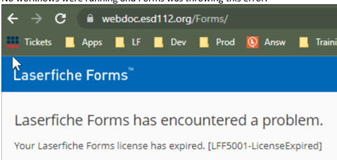

No workflows were running and Forms was throwing this error:
The first thing I tried was re-licensing the master license, but that did nothing. Also restarted Forms routing service and recycled appPools.

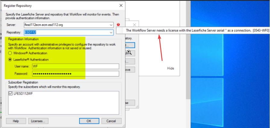

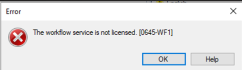

On the WF server I was getting these:
That pointed to the actual licenses for LFS and WF. I manually copied them over from the Directory server. I had to restart the WF service and LFS for it to correct itself. Then we were back in business. So from what I can tell the actual licx file on the machines expired OR those machines could not communicate with the Directory server. But could prior to and after again...which is super weird.
