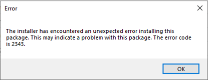

Laserfiche 11 Audit Trail (v11.0.2210.3156) install fails with error code 2343:

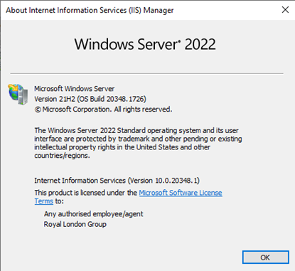

This is on Windows 2022 with IIS installed and running (v10.0.20348.1):

Hi, Barry,
The error code 2343 indicates an empty path during installation. I think installation log is needed to find out the empty path. You can get installation log by running installation with steps:

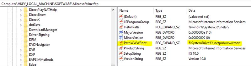

Could you check if the following IIS registry entry is correctly set?
[HKEY_LOCAL_MACHINE\SOFTWARE\Microsoft\InetStp]
"PathWWWRoot"
The registry looks like the following by default:
I get the same error code 2343 installing Audit Trail with this registry entry manually removed.
