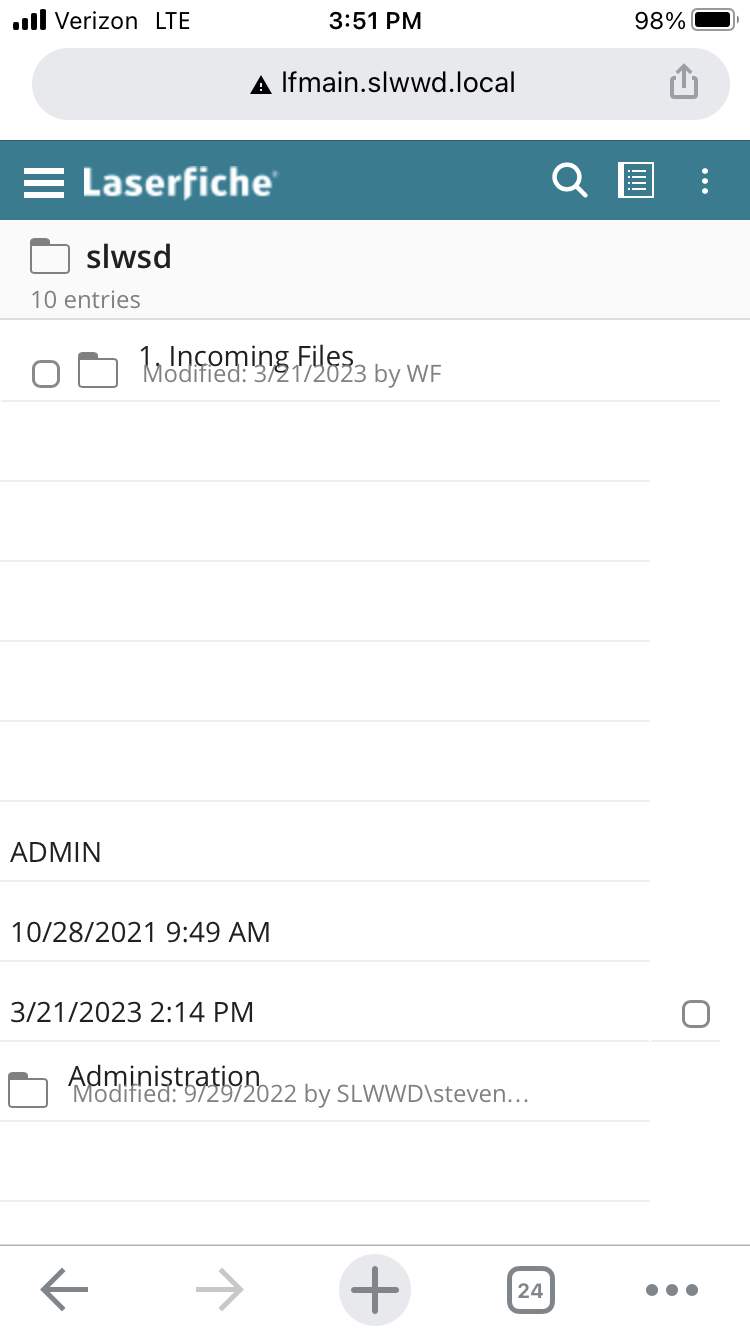

I have a user who is trying to use web client on an Iphone. They want to know if there was a way to format it so that it looks better. Below the file name next to the icon the words below are almost on top of the files name like they are merged together. When they change the dimensions to a higher resolution it fixes but they were wondering if there was a similar fix for lower resolution where the words were not on top of each other. It is an iphone SE and they are using Chrome's mobile view. I don't know if this matters or not, but the lower resolution has the words "Date modified (With the date)" and the higher resolution does not show that on the screen.

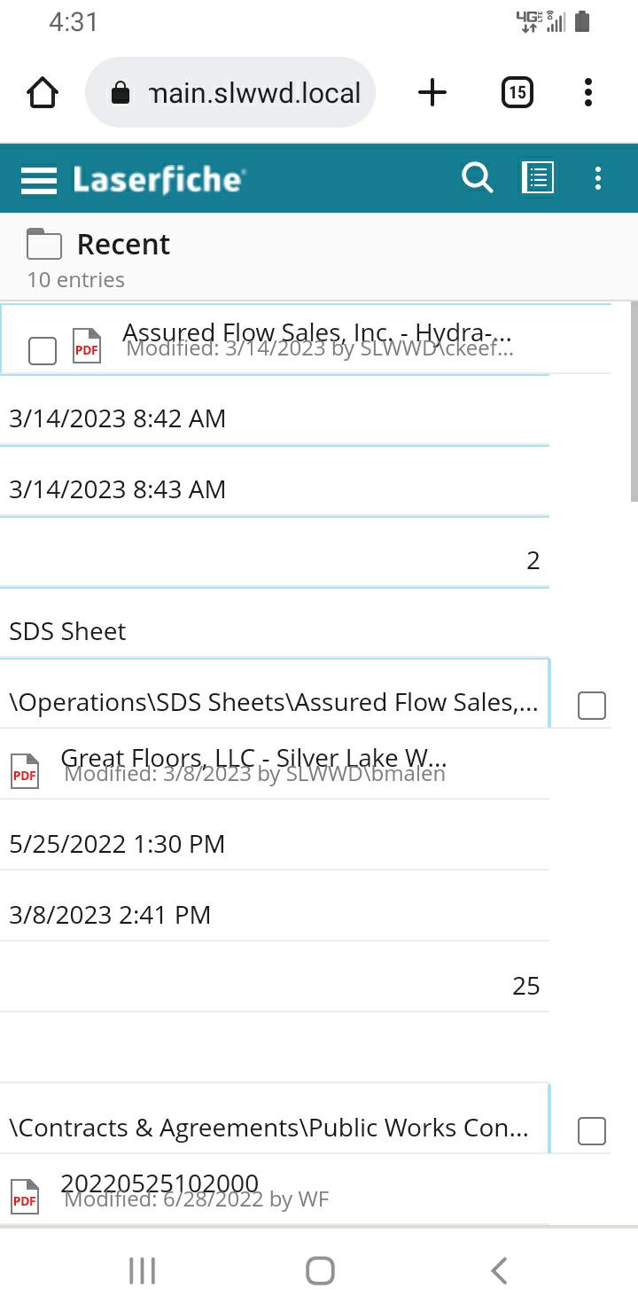

I have a Samsung Galaxy S9. I don't generally use it to access the repository, but with a quick test I don't see anything obviously broken. What do you find that doesn't work? I tested using Chrome.
For the iPhone SE, I don't have a physical device. The emulator in Chrome shows some toolbar items overlapping on such a narrow screen. Have you noticed more significant problems?

See attached screenshots for what the web interface looks like on iPhone and Samsung Galaxy S9. I had my Laserfiche reseller open a ticket with Laserfiche and they acknowledged this was a bug and filed under bug ID 420250. Waiting on a fix from Laserfiche.

I've seen the support case was updated with screenshots much closer to what I saw on my phone. Do you know what caused the odd layout in the first screenshots? Were some resources not loading?
replied on April 24, 2023
I don't know what is causing it to not load properly.
The updated screenshots attached to the case are after we upgraded our Laserfiche installation to the latest version (update 5 I think?). So they must have made some fixes.
