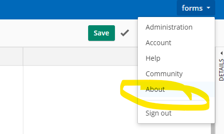

you can check the dropdown of your user name in Forms site:

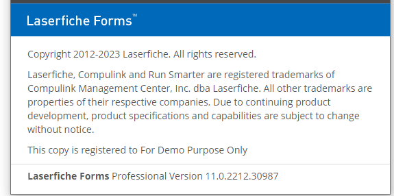

The popup dialog will have the version detail:
replied on March 24, 2023
Thank you...
Laserfiche Forms Professional Version 11.0.0.537
