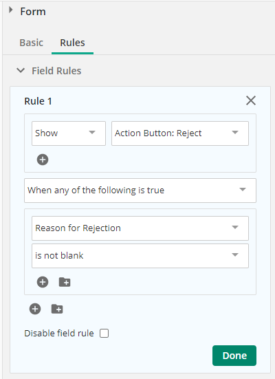

One idea that will work with the Modern Designer is to use the field rules.  And this is really where the Modern Designer shines, because the field rule options are more powerful.  You could make it so that the Reject button isn't even shown unless your field is populated.  Unfortunately, I don't think this can be tied to the standard comment box, but could be tied to a field you add.
The field rule on the form would look something like this:

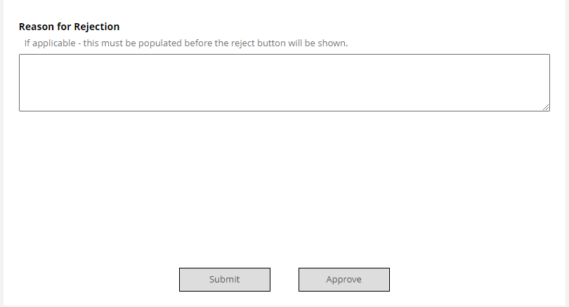

The form looks like this.
When the field is not populated, the Reject button is hidden.
When the field is populated, then the Reject button is shown.

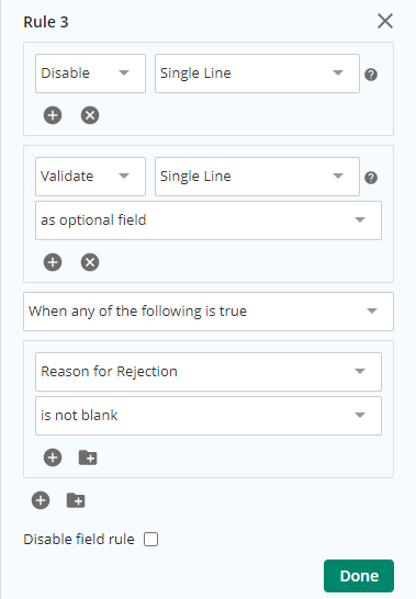

You could even add field rules on other fields that are normally required, but are not needed on a rejection - when the Reason for Rejection is populated.  Of course you can hide the fields.  But with the new options, you can now leave them shown but disable or change their required status.  Like this rule, that takes a field flagged as Required and disables it and switches it to optional if the rejection reason is populated.
