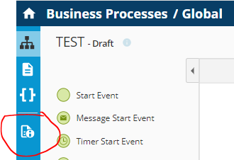

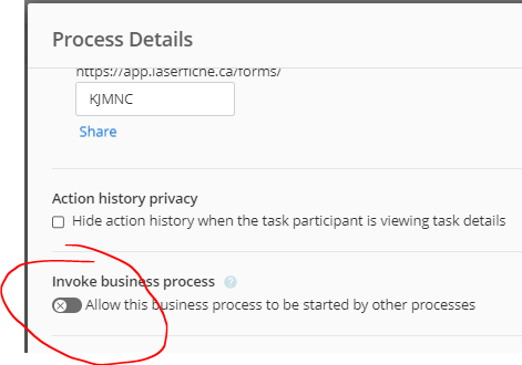

In your business process, under Details, you need to turn on the feature, Invoke Business Process so that a Workflow or another process can start this BP.
FYI, there is a similar requirement in Workflow
You'll need to Publish after turning this on
