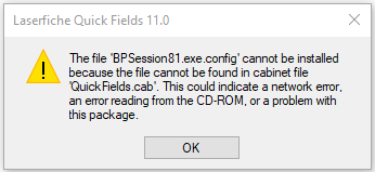

We just upgraded to 11 and I'm trying to install Quick Fields 11 Update 2 on a few computers.  It installs fine, but on first run we get the attached error stating that BPSession81.exe.config cannot be installed because it's missing.  Sure enough, I check the QuickFields.cab file and it's not in there.
Does anyone have a solution for this?  If it's a problem with Update 2, I don't have any of the older QF 11 installers and the support site seems to only have the remastered installer on it.  I've already tried re-downloading the installer again and it's the same problem.

Thanks for your information. The issue seems that there is a corrupted installation and Quick Fields tries to automatically repair itself but get errors during repair.
The repair error can be recreated and has been reported as Bug 395831.
While I couldn't recreate the corrupted installation by upgrading from 10.3, which happened in the first place. Could you try uninstall Quick Fields completely then install it again as workaround?
