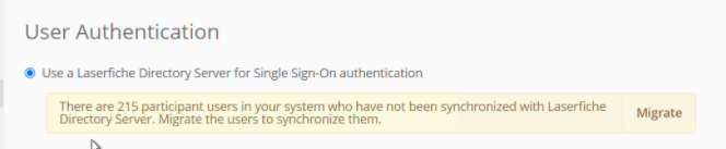

2. The Forms authenticated users will be migrated to LFDS when you go to switch Forms to use LFDS authentication instead of Laserfiche Server authentication. In the interface there will be a message that pops up similar to this one:
