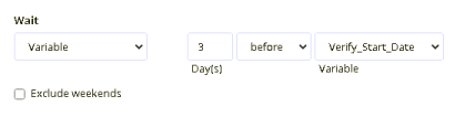

Customer built out a form and they kicked it off.  It is sitting at "In Progress" at a Timer Catch Event using the following variable:
Customer is trying to edit the variable but when they hit save they are getting the below error message:
"An error occurred while running the process. Please make sure Laserfiche Forms is configured properly. Manually restart Laserfiche Forms Routing Service to ensure that all necessary changes take effect."
