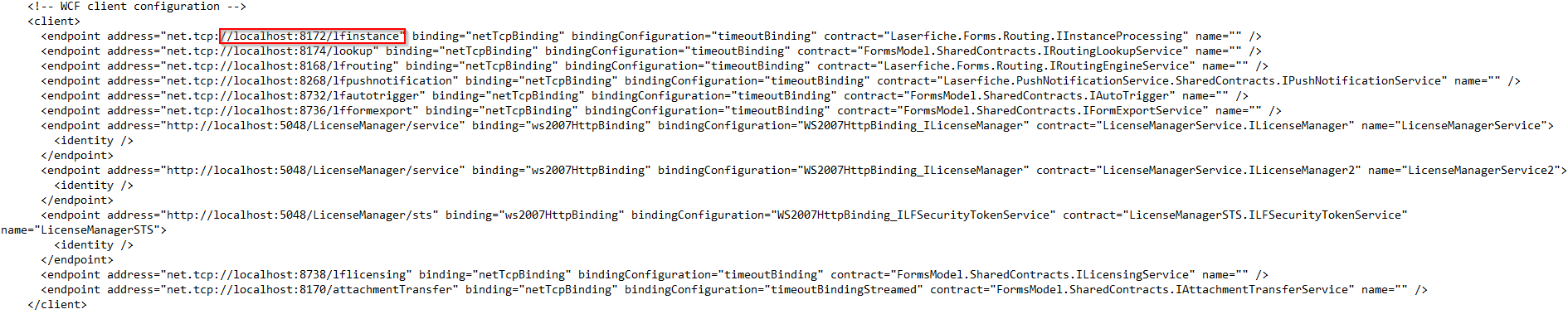

In the C:\Program Files\Laserfiche\Laserfiche Forms\Forms\Web.config file the line looks like this:
<endpoint address="net.tcp://localhost:8172/lfinstance" binding="netTcpBinding" bindingConfiguration="timeoutBinding" contract="Laserfiche.Forms.Routing.IInstanceProcessing" name="" />
In the C:\Program Files\Laserfiche\Laserfiche Forms\Forms\bin\RoutingEngineServiceHost.exe.config file there were two lines that looked like this:
<add baseAddress="net.tcp://localhost:8172/lfinstance"/>
and
<endpoint address="net.tcp://localhost:8172/lfinstance" binding="netTcpBinding" bindingConfiguration="timeoutBinding" contract="Laserfiche.Forms.Routing.IInstanceProcessing" name=""/>
As you can see, those three points all reference port 8172.

We switched the three references in the configurations to use Port 8176 instead of 8172, added Windows Firewall inbound and outbound rules to allow access within our domain to port 8176, and rebooted the server.  After that, all the errors were resolved, and Forms began operating as expected.

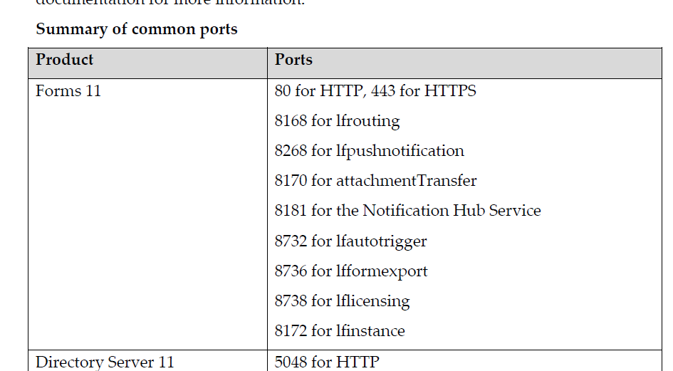

What happens if you run this command and you find that [System] is using all 5 of the ports that the Forms service wants to use:
8176
8168
8268
8732
8736
Why in the world did the system decide it needed these exact ports? So crazy.
I feel like services, when they crash, can leave ports open inside of the system even after the service is closed out of memory. This happened following a null reference error and forced termination of the Forms service.

@████████, I installed Forms 11 Update 3 in our test environment and when looking at the \Forms\web.config file I see that for the lfinstance endpoint that 8172 is still set. I do not see port 8176 configured on any of the end points.
replied on January 25, 2023
That's interesting @████████- I just checked mine on my test server (the only place I've upgraded so far) and it is showing 8176 in all three places across both files.  Of course, I had manually updated those in April 2022, but they both now show modified date of 1/13/2023, which is the day I upgraded that server.  I had assumed that it reinstalled those files, but with the modified ports.
We upgraded from Forms 11 Update 2 so I would have expected it to change the ports based on Xiuhong's post, but doesn't look to have done that.
replied on January 27, 2023
We only changed to 8176 when there is no existing port 8172/lfinstance during upgrade in order to keep existing system unchanged as you may need to open new port to make your system work.
