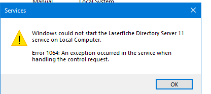

Error 1064: An exception occurred in the service when handling the control request.
asked on July 22, 2022
Does anyone know what could be causing this issue? Please let me know if additional information is needed. Thank you,

Hey Miruna,
We discovered that giving the service account administrative permissions allowed the Directory Service service to run; however, we can't allow the service account to continue running with administrative permissions due to security concerns from our infrastructure team. Do you know all the permissions a service account should have to get the Directory Server service to run? Thanks!

Hi Jarrett, did the event logs turn up any info? Typically they will tell you what is wrong. Starting a service doesn't require much else than the start service permission. You might also want to make sure that the service user has the ability to bind to port 5048/5049.
replied on July 22, 2022 Show version history
Hi Jarrett,
Your Laserfiche Solution Provider opened a support case for the matter and it should be resolved now.
The service account configured for LFDS is not a member of the local Administrators group on the server. In this scenario, make sure to manually grant the proper access to the account in question. See https://go.laserfiche.com/support/webhelp/Laserfiche/10/en-US/administration/Subsystems/LFDS/Content/Ports.htm
The below steps were performed to resolve the issue:
netsh http add urlacl url=http://+:5048/LicenseManager/service user=DOMAIN\User
netsh http add urlacl url=http://+:5048/LicenseManager/service2 user=DOMAIN\User
netsh http add urlacl url=http://+:5048/LicenseManager/sts user=DOMAIN\User
netsh http add urlacl url=http://+:5048/LicenseManager/sts2 user=DOMAIN\User
Then ran the endpoint utilities for LFDS and STS and specified the user principal name of the same DOMAIN\User
