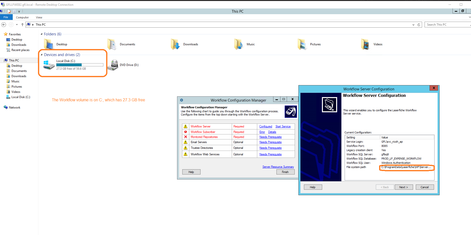

replied on June 21, 2022
Thanks Miruna
  I've edited my original post to include the entire error message. The Workflow volume is the C:\Programdata\Laserfiche\WF\ServerData location, right?
If so, the C: has sufficient space (screenshot attached). Is there any other place this can limited?
