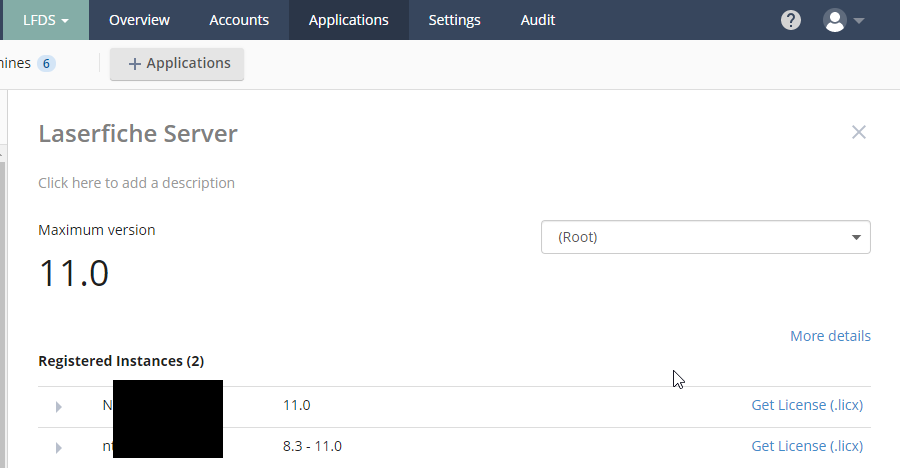

Ultimately, I did that. But the result isn't the exact same. This was a server that was already registered as 10.3.
One server I upgraded and activated during installation now shows as a 11.0 license in LFDS.
The server that I activated as you described shows the license is 8.3-11.0.
Why doesn't the LFDS update the details about the server license after I install the lf.licx file?

Kenny,
What you've noted there is essentially just a display quirk. The only version number that actually matters for the license is the highest ones listed, because it represents the "(Max)Version" property of the license. The "8.3-11.0" bit simply represents that LFDS doesn't know the installed software version at the time of license generation, so to avoid potentially misleading anyone it shows the possible range in the UI.
The actual Version value in the "8.3-11.0" license is identical to the one in the "11.0" license:
<InstalledApplication Guid="f7368d22-d055-4496-9d26-9577d73931ee" ProductId="74" Name="Laserfiche Server" Version="11.0" Databases="1000" ReadOnlyCpuLimit="0" ReadOnlyDualCpuLimit="0" ReadOnlyMultiCpuLimit="1000" ReadWriteNamedObjectLimit="10000" ReadOnlyNamedObjectLimit="10000" ReadWriteLfNamedObjectLimit="0" ReadOnlyLfNamedObjectLimit="0">
LFDS doesn't update this range to the actual installed version after the fact because to my knowledge, there is no post-installation version feedback mechanism implemented, and there's nothing to update in the license itself.
We have gotten a feature request on a few occasions to have the Version display label under Registered Instances be user editable so people can enter the correct version themselves after manual license generation. I'll add this as a vote to that request.
