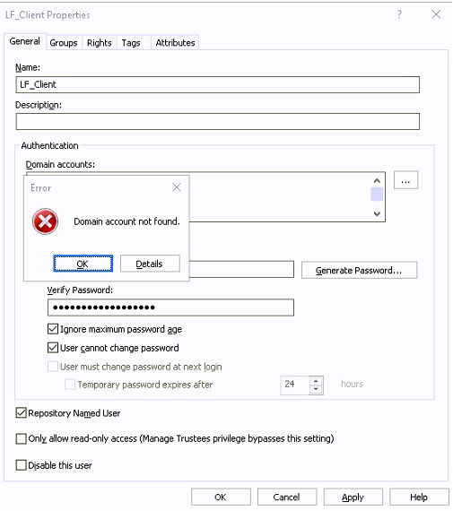

Error : Domain account not found, when add / modify Domain Accounts under Authentication
asked on April 1, 2022
Windows server 2016, LaserFiche 10.4
I have a named Repository Users with couple of domain accounts attached.
Everything was working fine before. It now gives error of "Domain Account Not Found" whenever I add or modify the domain accounts. I tried to use "Check Names", it found the users, but It prompts the error when I apply the changes.

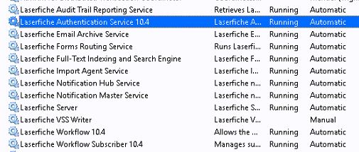

I changed to use my account for logon for LaserFiche Authertication and LaserFiche Server  services, but does not work and still same error message.
what other services should I change the log on account ?
