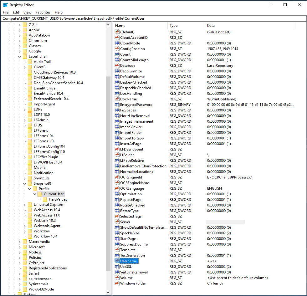

I believe the config setting is stored in a registry key under "Computer\HKEY_CURRENT_USER\Software\Laserfiche\Snapshot8\Profile\CurrentUser". Look for a key called "Username", which should have a value of "<wa>" for "Windows Authentication".

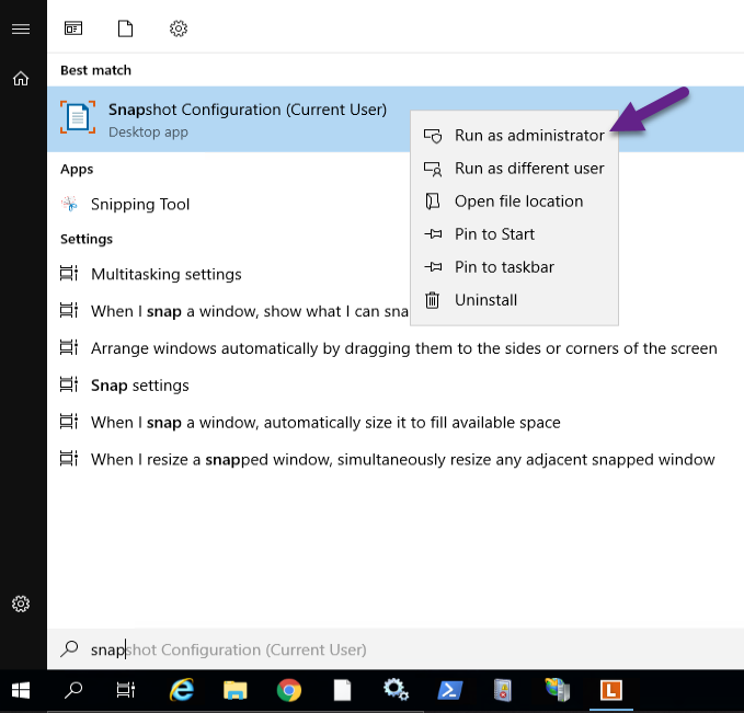

Even in a Windows Virtual Desktop/Terminal Server scenario with shared hosts, each user should have their own user profile and corresponding HKEY_CURRENT_USER (HKCU) registry area. It's possible the user accounts are so locked down they do not have sufficient permissions to write HKCU reg values, so the settings aren't "sticking". I'd have an IT admin try running the "Snapshot Configuration (Current User)" utility As Administrator, choose Window Authentication, and see if it persists in that scenario. If it does, they have a permission issue.

"I logged on to Laserfiche user's session and looked at the registry and the username value is wa. I ran the snapshot configuration utility as administrator but the Windows Authentication option did not stick and reverted to username and password."
Since they see  Registry Setting for Username with "<wa>", would this be a HKCU permissions issue or possibly something else permissions wise?
