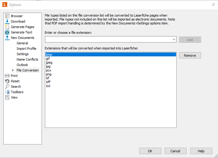

So it seems to me that Native documents is the preferred storage method, and Electronic Documents is the fall-back for document types LF doesn't support as native.  It seems crazy that the native format doesn't automatically keep track of the original document type.
I will need to discuss this with the users, but they currently pull out documents in the same format they were stored in.  If that is truly the case, is there a downside to removing all the extensions from the File Conversion options and storing everything as an Electronic Document?  My biggest concern would be if there's a big difference is storage size, such as if native documents are compressed more than electronic.
replied on November 18, 2021
Actually, native documents tend to take up a lot more space than electronic documents because TIFF images are fairly high quality and can get pretty large when they're in color or grayscale, especially when the source had a high DPI.
The downside of non-native documents is that you wouldn't have all of the Laserfiche editing capabilities, like annotations and such.
It all depends on how you intend to use Laserfiche; if you're just storing files and metadata and that's all you need, then keeping electronic files is fine. If you need to redact, stamp, add/remove pages, etc., then you'd need native documents.
