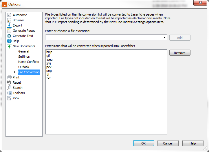

The problem is when I add TIFF to the list below, the Pages are generated just fine, but no electronic file properties.

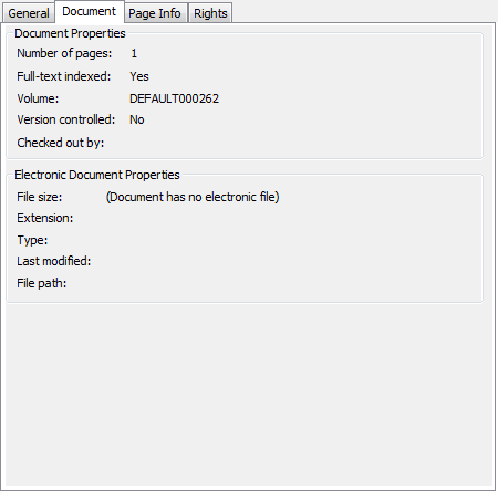

As you can see here, Electronic Document Properties are empty because the Laserfiche pages were generated.

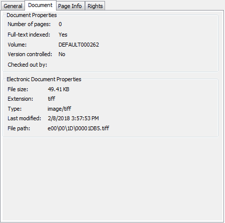

However, if I remove TIFF from the File Conversion and import the file the electronic document properties
