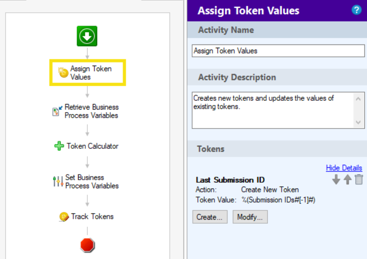

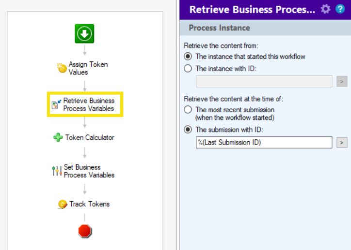

Hi Elexis, by default Workflow will retrieve content from time of the most recent submission (when the workflow started). Since the approval task before the Workflow activity is being interrupted by a Timer Catch Event, Workflow is looking further back and retrieving content from the time of the submission that precedes the interrupted task - in this case, the starting event.
If you enable "Started by Laserfiche Forms" in Workflow properties, you can retrieve Submission IDs from the Forms process and instruct Workflow to retrieve content from the most recently submitted approval task, even if it's in a different process branch. This way you can iterate vote counts in Workflow without overwriting them with the starting form variable values. I've attached two screenshots that should clarify the Workflow configuration.

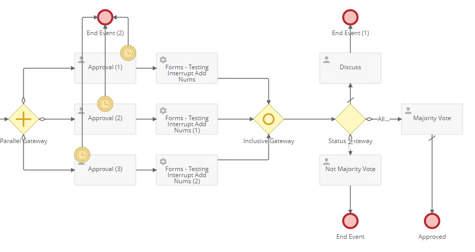

Hi Elexis, well having digging and playing with this some more, here is what I have for you. Because of the way Forms works you're going to have to change your logic a little bit, but not to much.
Explanation. By putting an Inclusive on the back of your parallel, it will wait for your User task to either complete or to be Interrupted before it can move forward. You must add the Workflow at each task so they can each exit to the Inclusive gateway otherwise if they grouped together at the WF Task the Exclusive gateway would only think it was waiting for 1 task and would allow that task to continue beyond the gateway before the others were completed.
In this way, you will know everyone voted or had their task interrupted as it will not continue past the gateway until that point.
For you decisions on the other side, your exclusive gateway can test the Total as the WF's increment the total as each task is completed, but does not run when interrupted. For your Exclusive task to see if a Majority voted or not, you can apply rules such as  ie: >3 then Majority, <4 then Not Majority, etc.

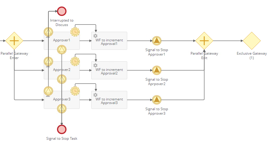

I'm thinking it's going to have to go something like this.
The WF task is all the same workflows but separated for each task.. When the timer goes off, it starts the workflow and then the signal(one for each approver) will Interrupt the task immediately. To you this should look like the form data is available when the WF starts. The Parallel exit means until all are the task are approved or interrupted it will wait until that is completed to move on.
