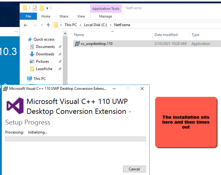

Anyone have this issue when trying to install Quick Fields?
It's telling me that I need this prerequisite:
When I try to install it (Microsoft Visual C++), it just sits here on "Initializing..." forever and won't install:
Is there a specific C++ that I should be trying to install?
Help!
replied on August 11, 2021
Run vcredist_x86.exe from Quick Fields' install media. It should be right in the root of the Support folder.
Alternatively, run Quick Fields' setuplf.exe from the command line with logging and open a support case with the log files.
<path to setuplf.exe>\setuplf.exe -log <path for log files>
We have been able to bypass requirements so long as later versions of the Visual Studio runtimes are installed.
replied on August 26, 2021
Thanks Miruna - that solved the problem.
