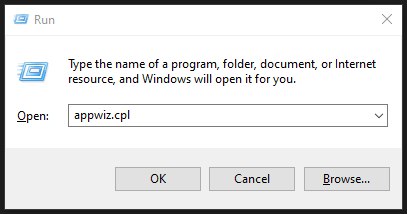

Everything is working now, and I didn't have to have my computer re-imaged, which I was almost ready to do.
The plugin problem was fixed with uninstall/reinstall.
What finally fixed the problem with Connector was when someone suggested I uninstall it by running appwiz.cpl instead of "Add and Remove Programs". Then when I reinstalled, it worked. It was that easy. I hope this helps someone else.

replied on June 29, 2021
