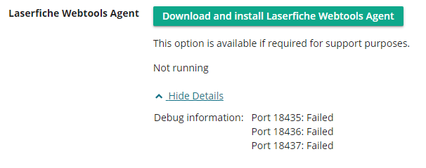

How is the Webtools Agent supposed to work?  I'm on Laserfiche 11 and have Webtools Agent 11 installed on my machine.  If I disable the Web Access Extension in MS Edge and attempt to edit a document with MS Word - I get a prompt to download and install Laserfiche Office Integration (but it's already installed).
Looking in Advanced options I see this:
How do I get Edge to recognize that Webtools Agent is installed?

Craig, are you on a terminal server? WebTools Agent needs to grab one of those 3 ports. On terminal servers where they might be more than 3 users logged in at the same time, it may not be able to get a slot.
The web client falls back to the browser extension, if it's installed. WebTools Agent is the preferred way of detecting whether Laserfiche Scanning or the Office plug-in are installed.
replied on June 21, 2022
I'm on a laptop PC so I'm not understanding why it cannot connect to one of the ports.
