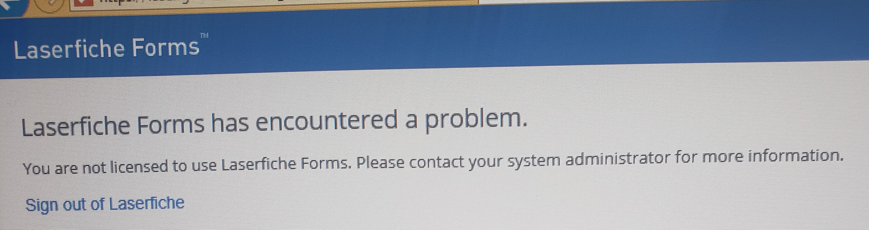

I have a user who has been assigned a Laserfiche Forms task for the first time, but when he tries to log in, he gets the following error message:
Laserfiche Forms has encountered a problem.
You are not licensed to use Laserfiche Forms. Please contact your system administrator for more information.

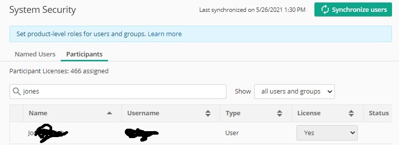

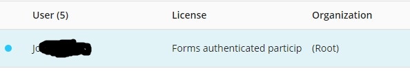

At first glance, this appeared straightforward, but the user is licensed to use Forms, I have run "Synchronize Users" and checked to make sure the user's name shows up in the list.
Any idea what I might have missed? I suspect something simple but I haven't been able to find it yet.
Error Message.jpg (843.15 KB)

I also double-check that he is indeed licensed on LFDS. In FormsConfig, I can't add individuals, but he's in an AD group and in an LFDS group, both of which have forms login permission on FormsConfig.

  • Check FormsConfig to be sure the user is in a group that has rights to sign in to Forms.
  • Make sure the Synchronize Users has been run on the "Administration" page of Laserfiche Forms.
  • Run "Synchronize" in LFDS under Settings/Identity Providers and check for errors.
