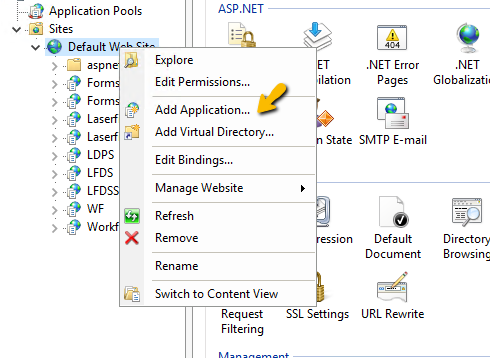

And can you try to manually add an application for the Web client app and check whether there is something wrong in the current test environment?
