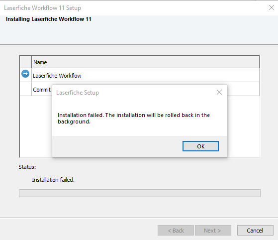

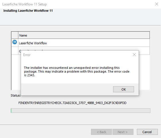

We updated our Laserfiche test environment to LF11 this week. We did not have any issues installing Workflow 11 on the server. However, when trying to install Laserfiche Workflow 11 Designer and Admin Console on our Windows 10 desktops, we are receiving an error code 2343. It appears the installer fails on writing system registry value FINDENTRYINREGISTRYCHECK.72A823C6_3707_48BB_9403_D62F3C9D0FDD. The installation will fail and roll back the installation. Has anyone else run into this problem and found a resolution?

The issue appears to be caused by not having IIS installed. I've confirmed this in testing and have filed Bug 312607 for the time being.
This thread will be updated again once a fix is available. For now, a possible workaround may be to install IIS on the PCs that need the Workflow Designer installed.

Also same issue, same scenario. Relevant section of Workflow.msi.log appears to be:
Action start 14:27:53: RemoveExistingProducts.
MSI (s) (98:A4) [14:27:53:745]: Doing action: SetARPINSTALLLOCATION
Action ended 14:27:53: RemoveExistingProducts. Return value 1.
MSI (s) (98:A4) [14:27:53:746]: PROPERTY CHANGE: Adding ARPINSTALLLOCATION property. Its value is 'C:\Program Files\Laserfiche\Workflow\'.
Action start 14:27:53: SetARPINSTALLLOCATION.
MSI (s) (98:A4) [14:27:53:746]: Doing action: ChangeDir
Action ended 14:27:53: SetARPINSTALLLOCATION. Return value 1.
MSI (s) (98:A4) [14:27:53:747]: Note: 1: 2343
Action start 14:27:53: ChangeDir.
DEBUG: Error 2343:  Specified path is empty.
MSI (s) (98:A4) [14:28:19:968]: Product: Laserfiche Workflow (x64) -- The installer has encountered an unexpected error installing this package. This may indicate a problem with this package. The error code is 2343. The arguments are: , ,
Action ended 14:28:19: ChangeDir. Return value 3.
Action ended 14:28:19: INSTALL. Return value 3.
