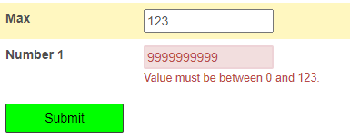

Hi Katy,
Here are a couple options to use the built-in max attribute; this way you don't need to hide the submit button because it will validate the field and show an error just like when you set a static range.

Either way, the result will be something like this

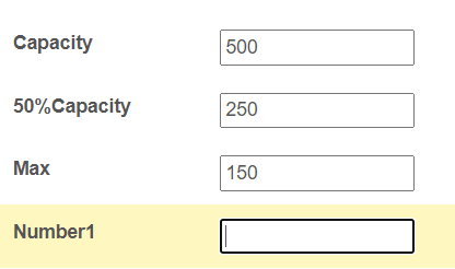

And, I figured it out.  I set classes on my fields (attendees and maxattendees), then used the following code
   $('.attendees input').change(function () {
     if ($('.attendees input').val() > $('.maxattendees input').val()){
     $('.attendees input').val('').change();
       $('.Submit').hide();
     else
       $('.Submit').show();

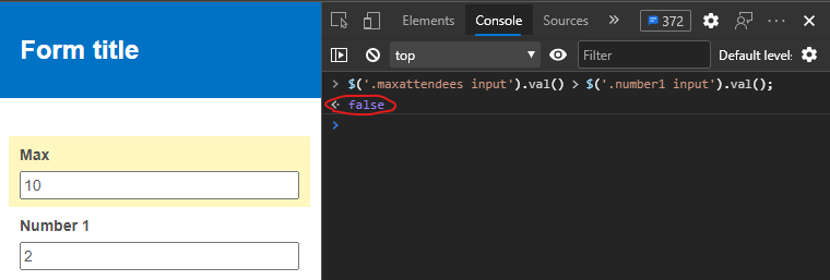

You want to be careful with value comparisons in JavaScript. If the values are being evaluated as text/strings instead of numbers you'll end up with unexpected results.
For example with string formats '10' > '2' = false because strings are compared alphabetically meaning '1', '10', '11' etc. are all less than '2'.
In order to ensure numeric comparisons you would want to use parseInt; this isn't a problem with the examples I posted because they're just setting the max attribute not doing the comparisons.

replied on March 3, 2021
You are AWESOME!  Option1 works perfect
