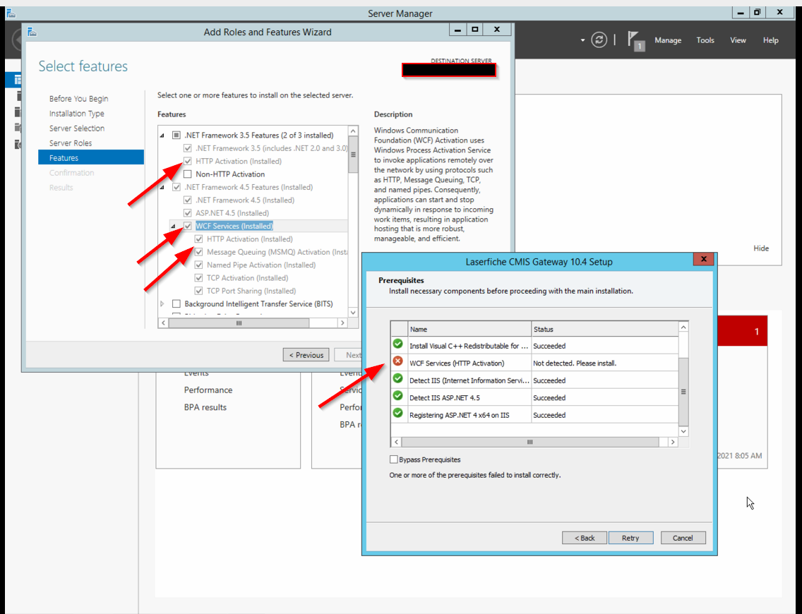

I also ran into an issue on installation - It misidentified the WCF / HTTP activation features as being not installed, when it was installed on the server then rebooted (see image) - wondering if I got the wrong WCF / HTTP activation or if it's a bug in the installer.
