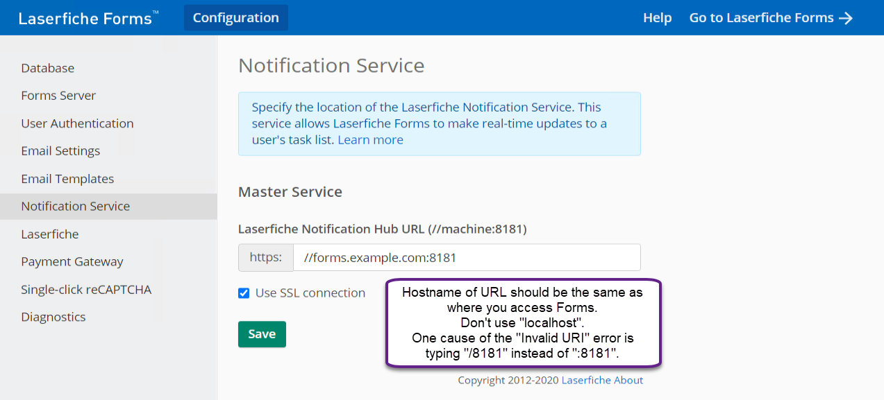

Most of the time we see that error it's due to a typo, invisible character, or similar issue in the Laserfiche Notification Hub URL configuration. See attached screenshot.
You can see from the stack trace that the error is coming from Microsoft's System.Uri library, so there's something in the string getting passed it can't parse.
That's something we should probably validate when you try saving the value in FormsConfig instead of at runtime though, so I'll file an enhancement request for a better validation check.

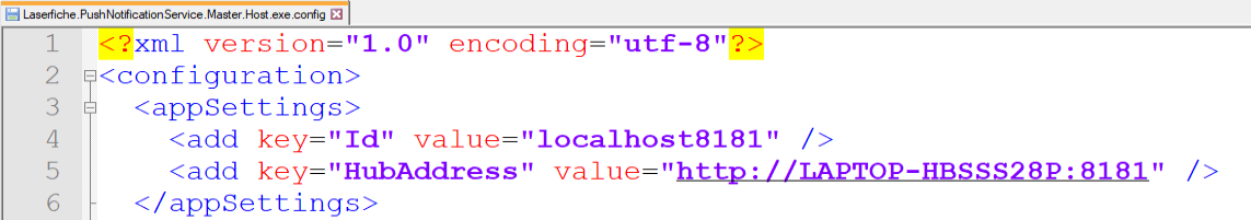

Try opening up the file at "C:\Program Files (x86)\Laserfiche\Laserfiche Notification\Service\Laserfiche.PushNotificationService.Master.Host.exe.config" and checking the HubAddress value under the <appSettings> node. That what the FormsConfig Laserfiche Notification Hub URL sets.
Set the HubAddress value to "http://LAPTOP-HBSSS28P:8181" directly within that file (replace it with a clean string even if it already looks the same), save, restart the three Forms/Notification services, and see if it works or if you get a different error.

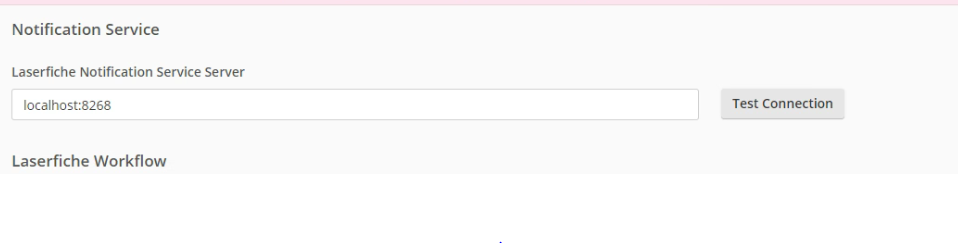

I found the problem, it is a problem with the latest installers. I just uninstalled and did a fresh install to confirm. Also this is not noted anywhere in the documentation, or I would rather have it right on the config page instead of buried in the documentation.
In the config app there is a Laserfiche tab, this tab ALSO has a notification service configuration (which is strange being that there is an entire section for notification service)
It looks like this and it is auto configured by the installer.
Test connection works showing that nothing is wrong with the connection.
However, simply changing the word localhost to the machine name fixed the URI error and now I see the count of tasks in my inbox. This one actually doesn't even have the //machine: requirement notated.
I was just trying random things and decided to replace this with the machine name, I can't understand how anyone else in the world has figured this out. How is this service working for anyone?

The "Notification Service" tab is for configuring the Notification Master Service (which needs the Laserfiche Notification Hub URL). The Hub URL is where Forms actually sends end users to get notifications.
The "Laserfiche" tab is for configuring the Forms Routing Service and telling it where to find the Notification Master Service and Workflow.
In nearly all cases, people run the Forms Routing Service and Notification Master Service on the same server, so the default value of "localhost:8268" works. I have never had to change it across dozens and dozens of Forms installations. Your machine name resolves down to localhost either way, and I promise that using the machine name instead is not itself what fixed things.
