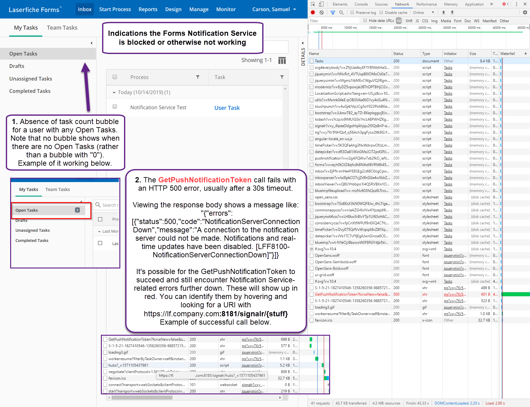

I can unfortunately almost guarantee that you do not have any DMZ Forms servers working with the Forms Notification Service. It requires special configuration and doesn't "work by default" for the DMZ instance. It's a relatively minor feature that doesn't break anything else when it isn't working, and people often don't know how to check.
Here's my verification process:

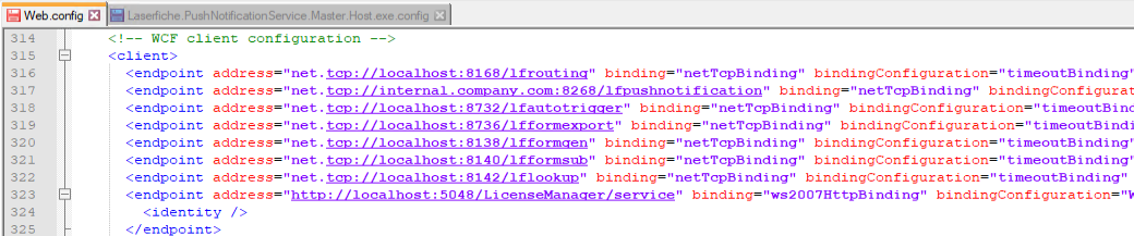

  4. Change Forms web.config on the DMZ Server to set the lfpushnotification endpoint to Internal Server.

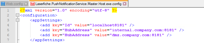

  5. Add another HubAddress key entry with the DMZ Server address in the Laserfiche.PushNotificationService.Master.Host.exe of the Internal Server.
    Then restart the Internal Server's Notification Master service.

replied on December 3, 2020
I pulled up the dev tools and it does show a 500 error
{"errors":[{"status":500,"code":"NotificationServerConnectionDown","message":"A connection to the notification server could not be made. Notifications and real-time updates have been disabled. [LFF8100-NotificationServerConnectionDown]"}]}
