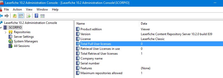

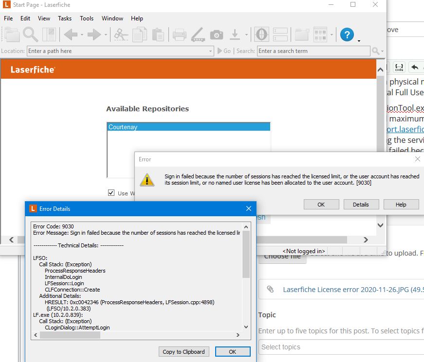

We copied over LF server from a physical machine to a vm last night. This morning I found that Administration Console says Total Full User licenses= 0. It is Avante ver. 10.2 on Windows Server 2008 R2.
I tried to reactivate using ActivationTool.exe. When I tried with the existing activation key, it said "Number of activation exceeded maximum..." or something like that. I managed to "generate" a new activation key from https://support.laserfiche.com/activationkeys/  and applied it. This time it went well without error but, after restarting the services, still Administration Console says Total User Licenses =0 and the clients get error "Sign in failed because the number of sessions has reached the license limit....".

After successfully deactivating the old key, I managed to reactivate it again and everything is fine now. Just for other users who will search this in future, you need two machine dependent parameters for deactivation:
1) Hardware finger print: you can find it from old "lf.licx" file (it's just text file, you can open it)
2) Machine's Host ID: Basically the old machine's MAC address (all ":" must be replaced with "-")
And then run the ActivationTool.exe in command line. Eg:
ActivationToolNet4.exe -deactivate -key ABCDE-ABCDE-ABCDE-ABCDE-ABCDE -fingerprint 1234567890ABCDE1234567890ABCDE12 -hostid 00-11-22-33-44-55

Are you using LFDS to licence your system?  It would appear that your .lic file isn't valid or present in your LF Server folder.  As your LF system has moved, this would also change the Hardware ID which is linked to your .lic file.  Before migrating your system, ideally you should have de-registered the server in LF and then reactivated it in the new server.

I echo what Anthony is saying, your license is invalid. I'm guessing becauser your hardware fingerprint has changed.
De-activate and re-activate your license to resolve the issue.
De-activation - https://support.laserfiche.com/kb/1012301/deactivating-laserfiche-products
Activation whitepaper - https://support.laserfiche.com/resources/3893/activating-laserfiche-products

We are not using LFDS but old style ActivationTool.exe. I tried to "re-activate" the existing key getting "Maximum number of activation exceeded". Tried new key and it ran smoothly creating a new .lic file but still I get 0 total user licenses.
Chris' answer gave me a hint that I had to "de-activate" first the old key. This morning, I tried your first link, downloaded ActivationToolNet4.zip  but the content was 0.  :-(
