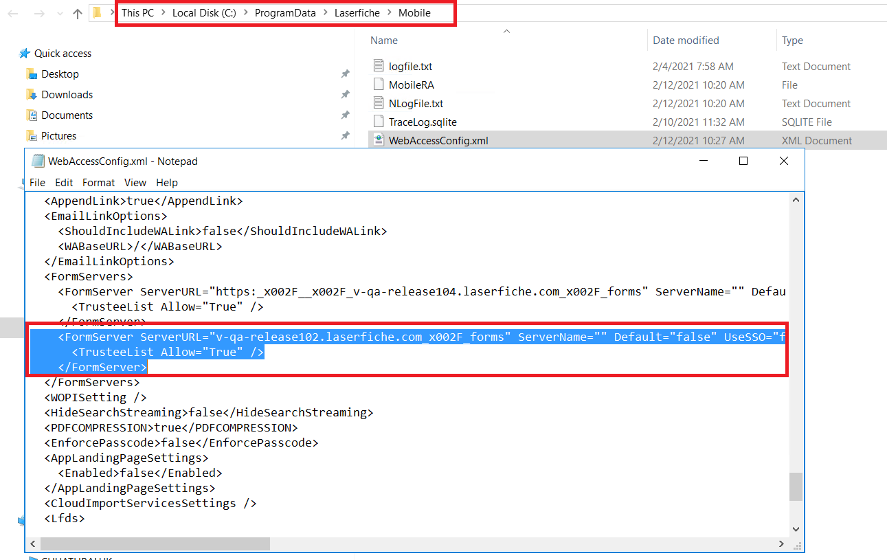

This issue is fixed and will be release with Laserfiche 11.
To fix an LFMS that is already broken by this issue, you can manually removing the broken forms server URL from the WebAccesConfig.xml file as pictured below.
replied on November 12, 2021 Show version history
I actually had to remove the entire <FormServer> element as removing just the attribute values still gave me the error. Once I performed an IIS reset everything started to work again.
Also I have noticed that it worked correctly when I added https:// or http://  in the server URL section instead of just the domain name.
