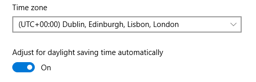

ICU is software that handles the time zone details. DST is "Daylight Savings Time". There is a decent chance the times will be correct once BST ends. Do you have the time set to automatically adjust for daylight savings? Like this:
