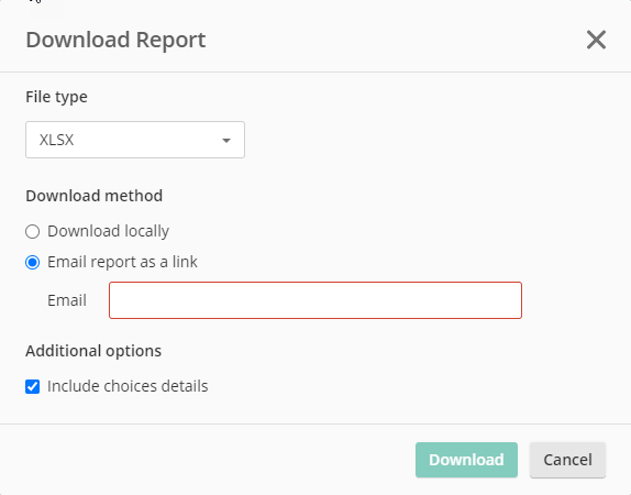

Hi Mark. I've seen something like this before for a large report. I believe the resolution was to email the report as a link instead of downloading locally. Note that if you still have issues, it may be worth trying the Schedule option.
replied on July 23, 2020
I tried the email report option.  I did receive an email, but when I click the "Click here to download report" link, I get: Error occurred during download.
An error occurred during download. [LFF4120-ErrorOccurredDuringDownload]
