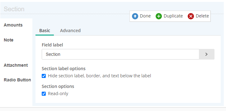

As a follow-up that won't help the current situation, you might consider making fields read-only in the future. Like, they need to be filled in on the initial form, but at later steps in the process make them read only. This can be done on individual fields, which is a pain if there are a lot of them, or by putting in Section separators since you can make a whole section read-only. Note that even if you don't have any sections in place currently, you can add one in and check the box to hide the section label, so it's there but not visible on the form people see. Just remember to add another section at the end of where things should be read-only.
