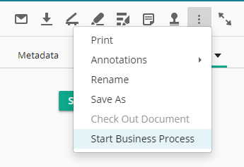

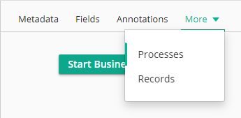

In the web client, you can initiate those processes under "More Actions > Start Business Process" or "More > Processes"
