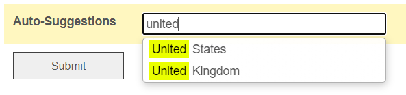

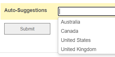

You should not use the same field for both the matching and the results. This will trigger a loop where it searches, display the result, searches, displays the result, etc.
What you can do is fill in all possible values into the single-line field and it will appear as auto-suggestions. When they click in the field, the entire list will appear:
And if they start typing it will filter the list:

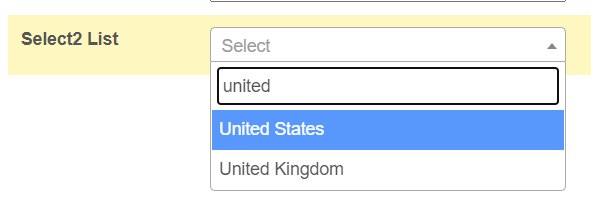

You could also use a dropdown and add a JS library that allows them to search and filter them, which would function similarly to the suggestions but will force them to select a value.
For #2, if your procedure already returns the top 10 then just target a single-line field and it will appear as suggestions as above.

I have been able to use a jquery library called chosen to create a dynamic lookup field for doing lookups and then set the lookup on the form to point to the data source and then not have a condition.
It was this article:  https://answers.laserfiche.com/questions/73762/How-to-Add-CSS-Class-to-Select-Field#166871 that lead me to doing the dynamic lookup.
For the lookup portion, I found this to work for using a database as a lookup to give a dynamic drop down, type ahead field.
I then end up with a field that will query the database and fill the drop down with that information and then it will type ahead like a search in google would do.
replied on May 27, 2020
That's exactly what I suggested with my "Select2 List" screenshot (though you used a different JS library). Again, it's not doing a dynamic lookup. It queries once and then lets you filter the list.
