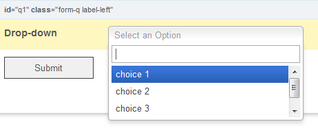

If you were getting an unexpected result like:
Then it's due to not having the CSS required for chosen.
Add the Chosen.CSS and it should work out just fine. Here's a link to Kelsey's Frost post on adding external CSS files.
For example, here's my full code for a test:
$(document).ready(function(){
$('head').append('<link rel="stylesheet" href="http://FormsServer/Forms/js/libs/chosen_c/chosen.css" type="text/css"/>');
$.getScript("http://FormsServer/Forms/js/libs/chosen_c/chosen.jquery.js", function () {
$("select").chosen()
Resulting in the desired behavior.

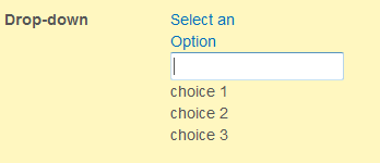

I can see in the source code that the js file is being referenced and that the class 'chosen-select' is being applied to the Select field correctly, but the Chosen plugin does not seem to be behaving as expected. If anyone has any advice on what might be wrong, I would appreciate it.
Ah, I had no idea this great library existed.

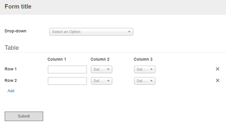

I have another challenge for you. I need to be able to use this in a table with 3 select fields in 3 columns. Also need it to work so when you add a row it works for the new rows. Are you up for the challenge?
// This next line binds the chosen stuff to the "add" new row button and grabs all drop downs on the page
$(".cf-table-add-row").click(function() { $("select").chosen();$("select").trigger("chosen:updated") });
$(document).ajaxComplete(function () {
$("select").trigger("chosen:updated");

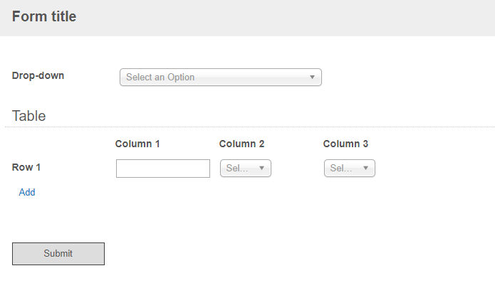

With the new line added, it worked for me
then clicking the add button yields
Any idea how to also make it work if the new rows are added from a database lookup?
