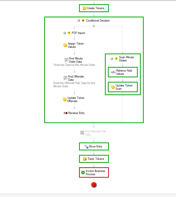

I am trying to initiate a workflow, its starts but then fails. Any help is appreciated.
replied on July 9, 2020
For us it was that HTTP Re-write was enabled to change http:// to https:// for all web requests. Workflow was configured to use http:// and when the URL is re-written it malformed the rest of the request. The fix was to update the workflow connection to match the re-write with https:// so that the request would no longer be malformed.

Thank you so much! This was my issue as well.  I changed my link to have HTTPS and it fixed the issue
