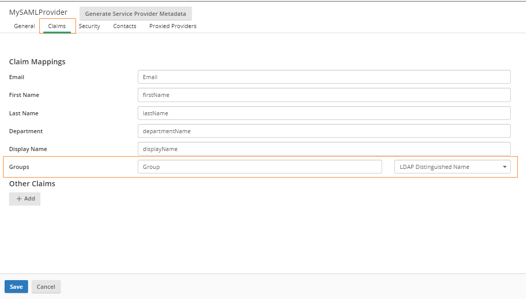

A client of ours is attempting to setup Claims Mapping for the SAML Okta Identity Provider. We are unsure about the Groups mapping entry. We have changed 'LDAPDistinguished Name' to 'AD SIDS'.
Should the 'Group' just be left as Group? If not, where can we find the attribute that should go there.

Unless you are using the proxied providers feature (designed for existing Windows users to switch to SAML authenticate), you can leave the setting on "None" rather than AD SID or LDAP distinguished name. We will be updating the label to be clearer in the future.
For Okta, the default attribute name is "group", but I believe Okta does not include the group attribute by default --- it must be enabled by an administrator. See https://help.okta.com/en/prod/Content/Topics/Apps/attribute-statements-saml.htm for instructions.
You can verify whether the attribute is on the token by using the SAML token interception instructions in the documentation.

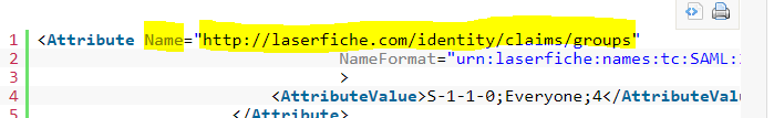

I have copy of the SAML trace and for groups, this is what it is showing:
<Attribute Name="http://laserfiche.com/identity/claims/groups"
                               NameFormat="urn:laserfiche:names:tc:SAML:2.0:nameid-format:SidAndName"
                        <AttributeValue>S-1-1-0;Everyone;4</AttributeValue>
                    </Attribute>

Ah, it's not the Okta groups you are sending over, so the "group" attribute is not the correct name. My initial response is only correct if you are not using proxied authentication.

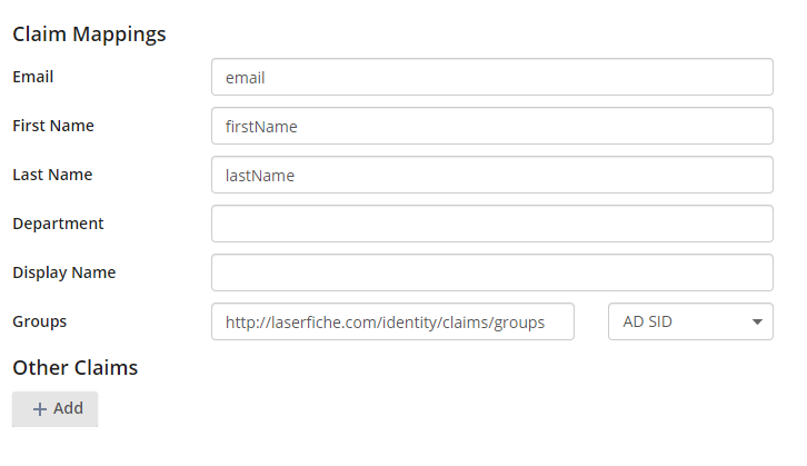

Based on the snippet you provided, you should specify the following:
instead of just the text "group" on the claims mapping page. This is the Name of the Attribute.
Based on the attribute value, you need to select the AD Sid option.
Filling out the claims section should be done by referencing a sample SAML token, since LFDS is always looking at the Attribute Name:

Taking the information from the customer's SAML token and putting it into the UI would look like (please ignore claims other than groups; I have simply put in placeholder values):
I cannot provide an example of the proxied providers tab because I do not have that part of the customer's SAML token.
Since this is information you should be taking from the SAML token based on their configuration, there is not a standardized value that we can provide/document.
The text box portion is the exact same thing as the value for the Name element in the SAML token. The format dropdown should reflect what is shown in the value: in your example, it's AD SID formatted. My developers confirmed that the "Everyone" value there should not cause problems.

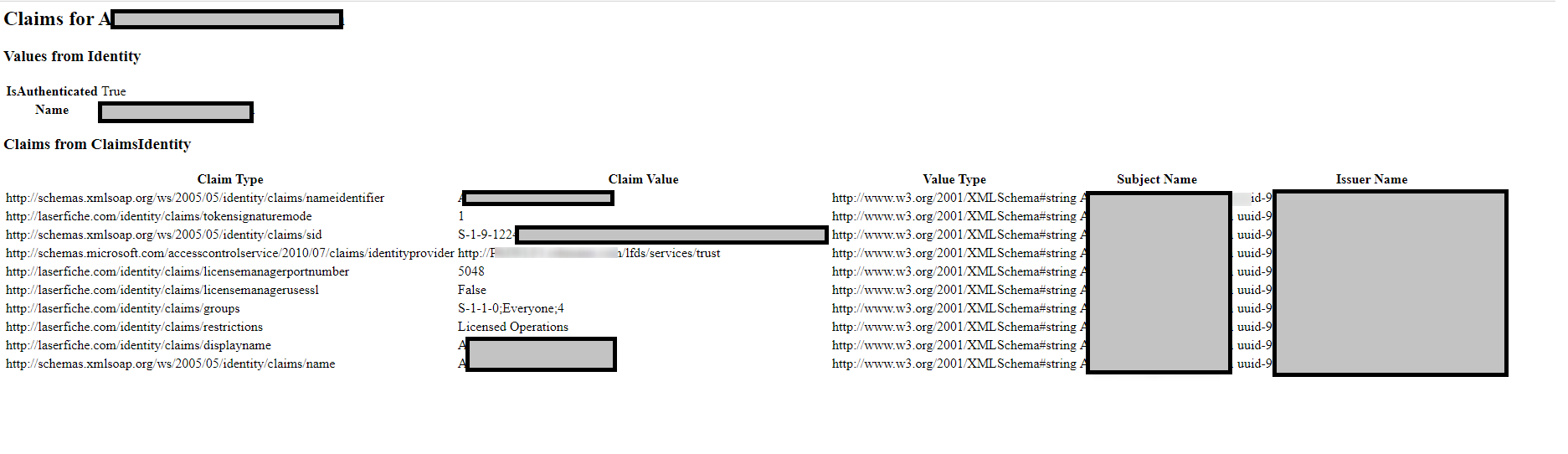

To troubleshoot group membership and whether the user is mapped, use the claimstest page by having the user navigate to
https://yourSTSmachinename.com/LFDSSTS/claimstest
It should show a list of all groups the users belongs to as well as the SID LFDS has for that user. The SID on that page should match the AD user SID, and the groups should match the groups SID list you provided earlier + any LFDS groups they belong to.

Brianna,
Here is the claimstest results. The groups do match with what was provided earlier. It doesn't include any LFDS group as far as I can tell. It seems that the User's AD SID (S-1-5-21-#########-##########-##########-###) is different from what is in the Claimstest (S-1-9-122#####-##########-##########-#########-#########-#).  I guess this is the issue. Any ideas how we tack this?

replied on April 30, 2020
It means that the identifying attribute LFDS knows about for the user does not match the attribute included on the token. For proxied providers for AD identity providers, LFDS uses their AD SID.
This may mean:
  1. You have the proxied provider "Identifying Attribute" incorrectly configured.
    Like with groups, what this is for your customer can be determined by looking at the incoming SAML token.
    Unless the SID is in the "NameID" section, you want to use the value of the Name element on the appropriate attribute. It seems probable that you want the AD SID format given that the groups are in that format (rather than encoded)
  2. Okta is not sending over what you think it is --- again, determine this by looking at the SAML token. It could be that the attribute isn't being included, or that the mapping in Okta is incorrect and the wrong value is incldued.
Just like with groups, you must send over the AD SID on the SAML token for the the user to get proxied authentication to work.
