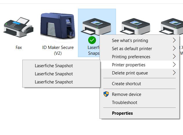

replied on May 22, 2020
This may be related to the issue (or a rabbit trail).  Printer information displays multiple times.  When I go to printmanagement.msc, however, I do not see multiple copies of anything related to snapshot.  When I look or change settings for any selection, all are affected so I think they're merely shortcuts pointing at the same thing.  I've tried deleting, for example, one of the print queues but it removes queues for every snapshot reference.
replied on May 25, 2020
Probably was a rabbit trail, another user with the snapshot problems had the printer information displayed properly...
