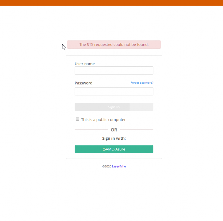

We are deploying a SAML with Azure and after we enter the configuration following the Laserfiche SAML Azure documentation, it doesn't work.
We are getting an error: The STS requested could not be found.
Certificate is good so no sure where to go from here
2020-03-16 08_54_14-CSDCSO_Viamonde - AZURE (App & Web Server) -  [v. 7.00.12][#48133164] [0_00_36] .png

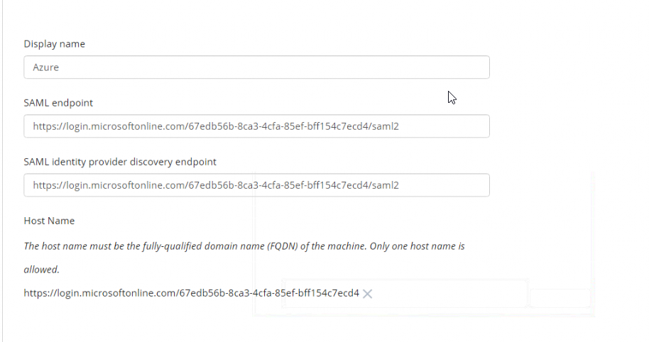

Your SAML endpoint is wrong.  Yours is pointing to the Azure login
The white paper example shows it pointing to the LFDSSTS site
replied on March 16, 2020
the LFDSTS site has to be the internal domain name or the public?
As I recall, it is for the STS site that you are configuring.  If you are configuring for external access, I believe that the URL should point to the Public name.
Insure to include the /saml2/sso as shown in the sample URL.

From your Azure App, did you export the SAML XML metadata and then import that into the LFDS SAML Identity Provider?
After configuring the STS site for SAML Authentication, did you export the LFDS Metadata as XML and upload it into your Azure App?
After you upload the LFDS metadata to Azure, you need to verify the "Identifier" property.  Since You only have 1 LFDS site, the "Identifier" property needs to point to the internal LFDS site.
It may be that the SAML Endpoint asked about in previous posts needs to be the internal name.  If just the above does not work, change the SAML Endpoint and then re export the LFDS metadata and re upload it to Azure and try again.
