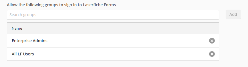

You need to assign the licenses to a user either by syncing an identity provider in LFDS and assigning the license to the goup ( I use AD groups).  If the users aren't in your AD, you can create a Laserfiche User in LFDS and assign them the participant license.  You will also need to assign them to a LFDS group that you create which will be one of the groups that has access to forms (setup on the User Authentication tab in the formsconfig page):
 For the repository - add the LFDS group within the Laserfiche Directory Accounts node in your Administration console under Users and Groups.
