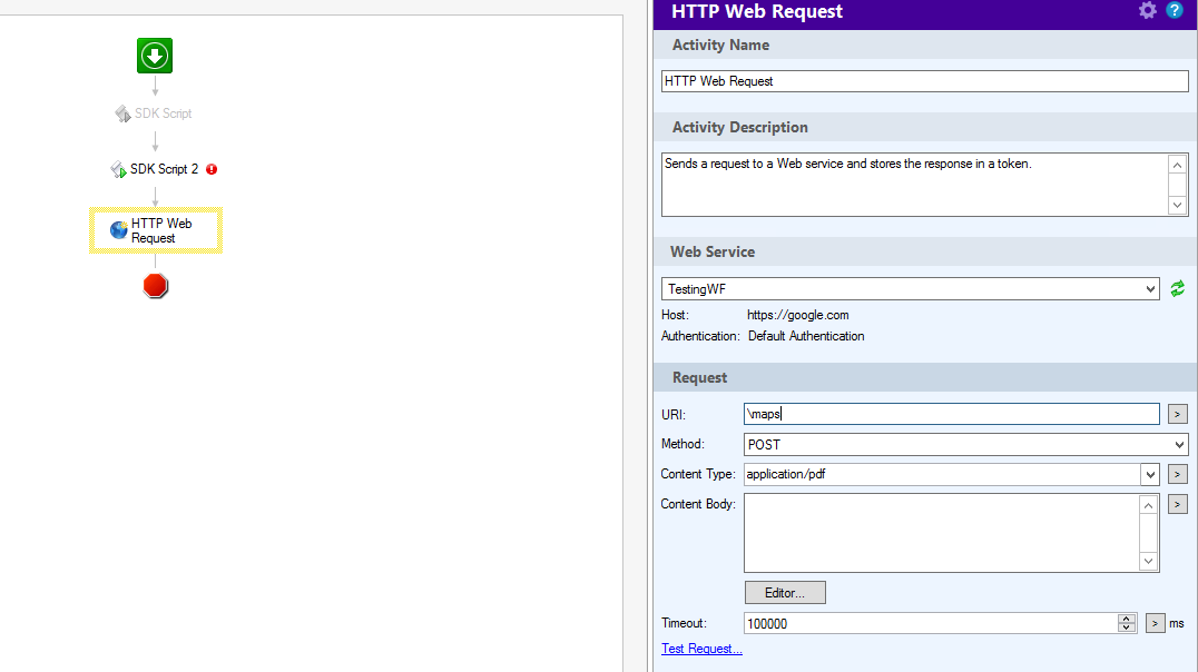

I want to write a WF SDK Script where I can convert tiff files into pdf, and instead of putting them into a network drive I want to be able to send it across an HTTP Web Request (the whole file) this will be a POST call.
Right now, I have a WF which sends the metadata over the HTTP Web Request, but now I want to send the whole file.
Thanks.

Hey Bert, please help me understand this. I'm sort of lost, I get was Bill is saying, but if you can explain it a bit further.
I also make a WF as a reference.
I'm thinking about these steps below:
1. Take tiff files and convent them to pdf
2. Take those pdf document to memorystream and then convert the ms to a Base64String
3. Then send the string out to the HTTP Web Request Post call
     a. what would be in the content body in the POST call?
4. All these would be a part of an LF WF
Edit: added few words.

replied on February 13, 2020
Bret,
If I modify your example from Workflow to Export Document to Windows Folder
Next, take Bill's code from above about SDK DocumentExported to MemoryStream PDF question
and then add
SetTokenValue("TokenName", Base64StringObject)
all that in a Workflow to make the HTTP WebRequest, would that be possible?
