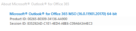

I too am able to reproduce this. It must be done in Chrome though. This only happens when dragging and dropping, using the Laserfiche Office Integration works correctly and copies the email. This is using Web Client:-
Laserfiche Web Client
10.4 (10.4.1.35)
Laserfiche Repository Access
10.4.1.48
Outlook
