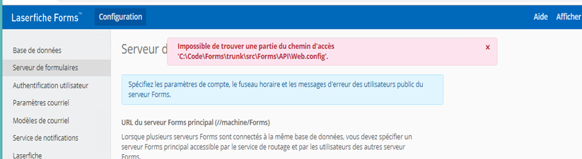

In the Forms config we can see this error, the folder doesn't exist.we created it so they can work with forms . of course the error gone but it still doesn't save pdf.
any help.
