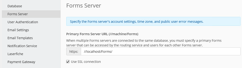

replied on September 1, 2017
Ran into this issue after an upgrade.  Looks like what Chynna ran into was our issue.
What resolved it for us was verifying the Primary Forms Server address and making sure SSL was checked. After the upgrade, it was left blank, so filling it in with //localhost/Forms and checking the SSL box made it work.
