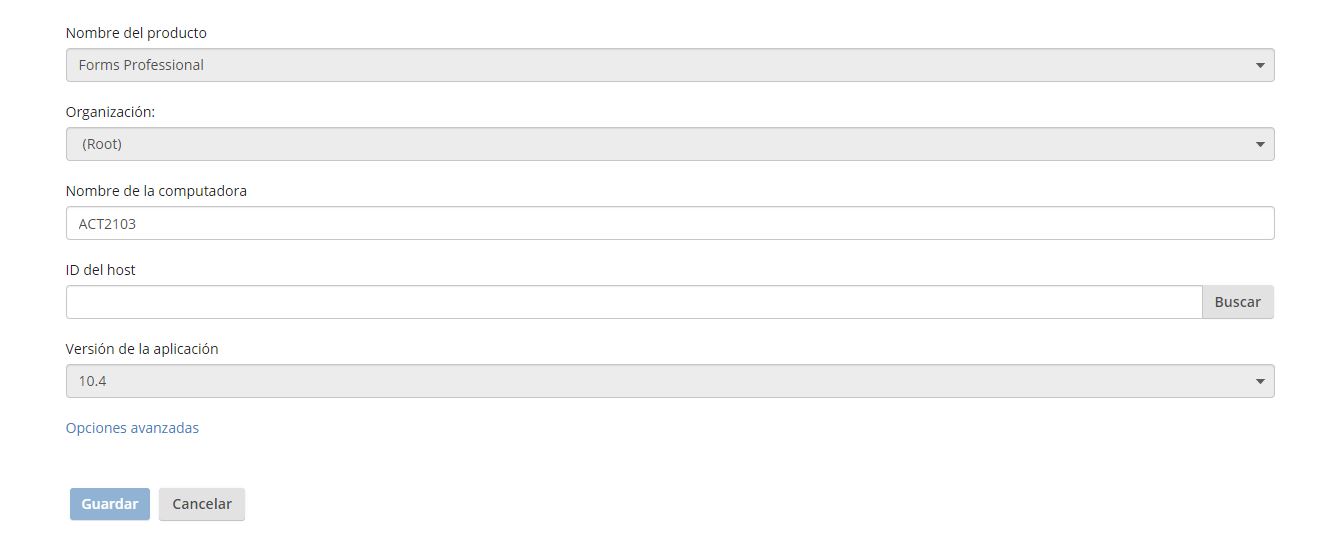

I have the following question, nowadays, a license of Avante System, and with 40 participating users, the question has been that in the directory server I do not have the option to assign the participating licenses to Forms as I usually needed to do The assignment.
How do I get this to happen? Since I have been searching but in the Directory Server when the license for Forms Professional is created, I do not have the option to do the assignment of the license!

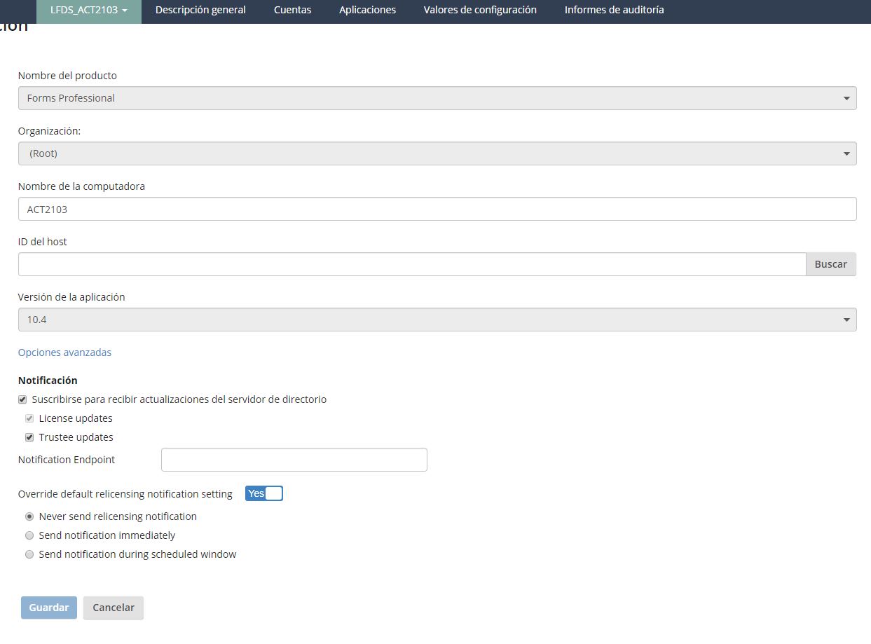

What choices do you have under "Advanced Options"
replied on July 15, 2019
This is what appears in "Advanced Options"
Interesting. What do you see when you don't have "Opciones avanzadas" selected?

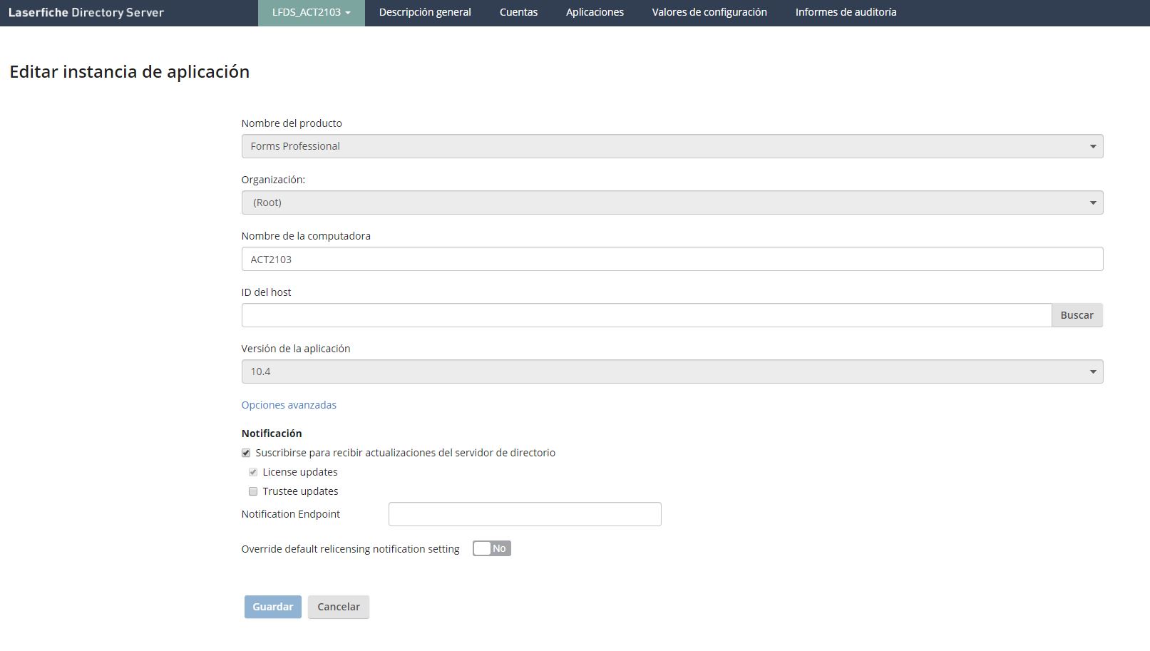

Does anything change if you identify the host? (clicking "Buscar")

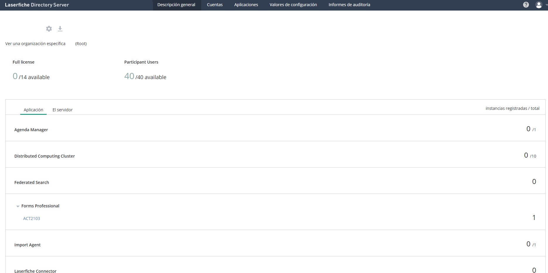

Do you have any participant licenses available? Can you show the main page where the number and type of available licenses are displayed?
There is the main page.
