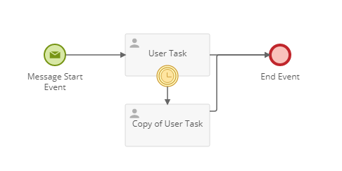

You need to do something like the process below. If you wrap the timer boundary event back into the same user task, it will interrupt the existing user task, create a new user task, but the new user task will already be passed the timer, so it will loop again and again. After the timer event hits 1 day before the due date, you need the process to go to a different user task (with all the same settings) but with no timer.

The design is technically working as intended. The instance waits on the user task until 1 day before due_date, at which point the timer event is triggered and the initial user task is interrupted. At that point, the path wraps back around to the user task with the same timer configuration. It detects that it needs to wait for 1 day before due_date (which is already here), then fires again, and again, and again...
One solution would be to set the timer to remind the user after x days and only repeat every x days. That way, when the new user task was assigned, it would wait another x days before reminding again. The problem in the current design is that the reminder condition is still being met (1 day before due_date).
Another solution would be to make an identical user task and have the timer boundary event go into that one. The only difference would be, the new user task wouldn't have the timer boundary on it, so it wouldn't keep sending emails. At 1 day before due_date, the initial user task would be interrupted, the new user task would be triggered, and the user would get another reminder email (which you could even customize different to say you only have 1 day left).

replied on June 25, 2019
Effectively yes. It's not about the due date, it's about the timer boundary event (but you are using the due date in your timer boundary event, so they are the same in your case).
If you set the timer boundary event for a specific date and time, whether it's before/after a variable or just a set time you choose, you cannot wrap the timer back around to the same user task. This is because the new user task you would be creating is already "over due" since it's past that time you set. This is also a problem for the Wait until case. If you wait until Jan 1 to throw the timer and then wrap back around, it will still be passed Jan 1 and it will throw again and again.
If you set the timer to wait for a specific amount of time, that will work. The first user task will be interrupted after 2 days (for example), the process will wrap back around and create a new user task that also has to wait for 2 days.
