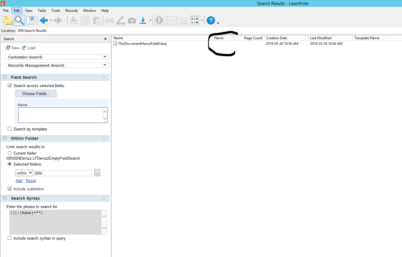

replied on May 30, 2019
So I replicated this..
If I search for nothing on this field and the value has nothing in the Repository it hits for me.
{[]:[Name]=""} & {LF:LOOKIN="ISN\ISNDev\zz.LFDev\zzEmptyFieldSearch"} is my final syntax which worked in Workflow too.
